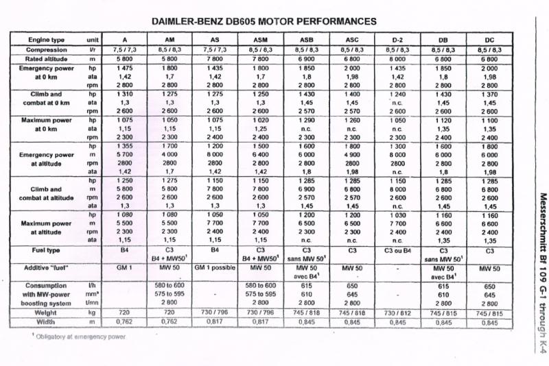

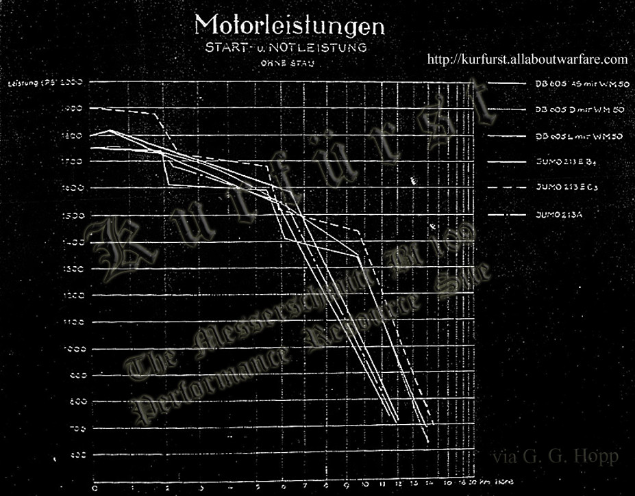

Here is also some engine data that was used when programming the DB 605 ASM engine of the Bf 109G-14. The numbers are most likely under min RAM conditions.
