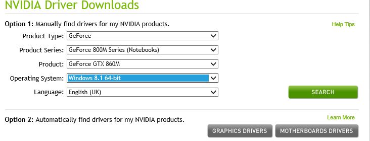

Does it only do that when playing warbirds or when general browsing also?
Is your windows up to date?
does sound like a driver issue.
aside from windows update
nvidia gpu update
http://www.nvidia.co.uk/Download/index.aspx?lang=en-uk

It only happened while playing WB's. General browsing seems fine. I did run the Nvidia update you have linked plus I did run some optional Windows updates that were additional besides the general Windows update I ran this morning.
I will test WB's out again here in a bit, and Thank you very much for your time and knowledge Bollok!
