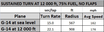

I did some turning tests for fun, since asked why the G-14 could turn at 14.1 sec per lap, when ww2 trials indicate 22-23 sec/lap. My turn tests were at sea level at only 50% fuel, while ww2 trials usually were at 12000 ft with more fuel. This makes several seconds per lap difference since the air is thinner the higher up you go, and more fuel means more weight. I also turn at max WEP setting, while sometimes in real life tests they used military power (less hp/weight ratio means worse turn rate). Below is a turn test of the Bf 109G-14 flightmodel when turned at sea level vs 12 000 ft, at 75% fuel. At 12 000 ft the turn performance is quite close to the 22-23 sec/lap data from real life tests.

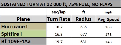

Below is also a turning test I just made at 12 000 ft, 75% fuel, between the adversaries of the Battle of Britain. I hope someone finds it interesting :). The Bf 109E-4Aa holds a really nice turn radius thanks to the high max AoA from using slats, but can't match the Hurricane and Spitfire in the turn rate. The Hurricane also has a high max AoA with it's thick wings. The Spitfire is quite close to the Hurricane I in turn rate even though it has really thin wings compared to the Hurricane. This is thanks to it's eliptical wings and thus low induced dragco, but the Spit holds a larger radius due to the low energy bleed. Having a good turn rate is more important than holding a lower average speed in the turn though, so the eliptical wing is a good thing and the Spit would not have been able to match the Hurricane's turn rate as well with a more square wing shape that resulted in a larger induced dragco. With the quite narrow turn radius the Bf 109E-4 can be dangerous in the first lap of a turn fight against a Spitfire as it can keep inside the Spit's radius for a while, but the Spitfire should easily get on the Messerschmitt's tail in any prolonged turn fight if the pilots are of equal skill.

Oops, I typed incorrect numbers for the turn test results of the Spitfire above. It has now been corrected.

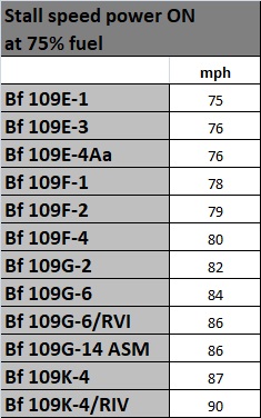

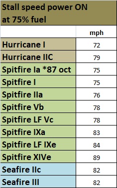

The flightmodels are set for power ON stall speed, which is usually 7-11 mph below power OFF stall speed (also depending on how much manifold pressure you use). The code doesn't account for the air blown over the wings by the airscrew, so the liftco has to be set higher to simulate the determined power ON stall speed. In the game the power OFF and ON stall speeds are the same, due to the code, whereas in real life they vary. As such the liftco used probably doesn't match normal liftco data that only focuses on the wing's liftco without counting the air blown from the propeller. When determining the stall speed one firstly checks for ww2 data available, but usually has to calculate it based on wing area/weight/max AoA etc, since ww2 stall speed trial data is often very arbitrary and varies greatly from different trials of the same airplane. The data can give a good guideline though, and sometimes can be quite precise like the P-39 stall data from NACA. Sometimes the ww2 stall data is just completely whack, like the Pilot Manual of the F6F-5 stating a stall speed of 71 mph (62 knots). This must be due to instrument errors since it's quite illogical that the F6F-5 would have a lower stall speed than an A6M Zero. (Wingload of 37.2 vs 23.0).
Below is the in game power ON stall speeds for the Spitfires and Messerschmitts. If you check ww2 trial data the Spitfire I and Bf 109E-4 had quite the same stall speeds in real life, so the Spit and Schmitt series should be quite historical in game relative to each other.

I think the POH for the Hellcat confused MPH and knots per hour.
My data sources are aligned with 72.9 KNOTS power on and about 78=79 KNOTS power off. That's 15 percent higher, and inline with what one would expect from the wing loading.

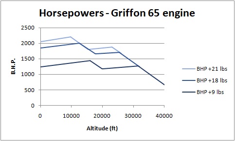

The cooling effect of MW50 allowed "higher boosts" to be used without detonation.
IIRC. The Bf109 could run MW50 for up to 10 mins at a time and had enough water reserves for 20 min total use.
In the same way, 150 grade fuel which the allies used late war in EUROPE worked in the same manner.
The additional cooling effect allowed higher boosts to be used without detonation.
Hence why I think the +18lb boost level on the Spitfire XIV should be re-instated as BST2 (with+ 21lbs as BST3).
If the spitfire xiv was safe to run at +21lbs for 5 mins WEP, it should be good for say 7.5 mins at +18lbs before engine overheats.
If you know anything about how the throttle body worked on a spitfire, you would realise that they were fully automatic.
As you increase the engine REVS with the throttle lever it automatically increases the pre-determined BOOST to match.
UNLIKE many American planes where you had to MANUALLY adjust engine RPM and BOOST!

I have good data on the Griffon engine so shouldn't be a problem to program that. Question is will it be of a large enough benefit to the player, or will it make the boost system for the Spitfire XIV more clunky, resulting in people accidentally choosing boost3 instead of 100% and overheat their engines more frequently? +18 lbs for 7.5 min is 200 hp less for nearly the same heat build-up penalty compared to +21 lbs for 5 minutes.
What is the exact reason why one would want less hp in a fight at almost the same heat build-up penalty, and also having to handle 3 boost stages instead of 2 boost stages? In what way would it benefit you? If the benefits outweigh the drawbacks then I can of course implement it for the next update. Maybe should make a voting poll?

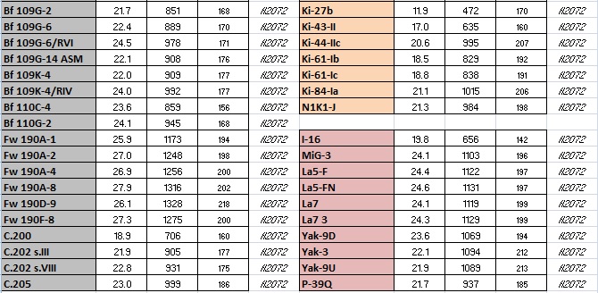

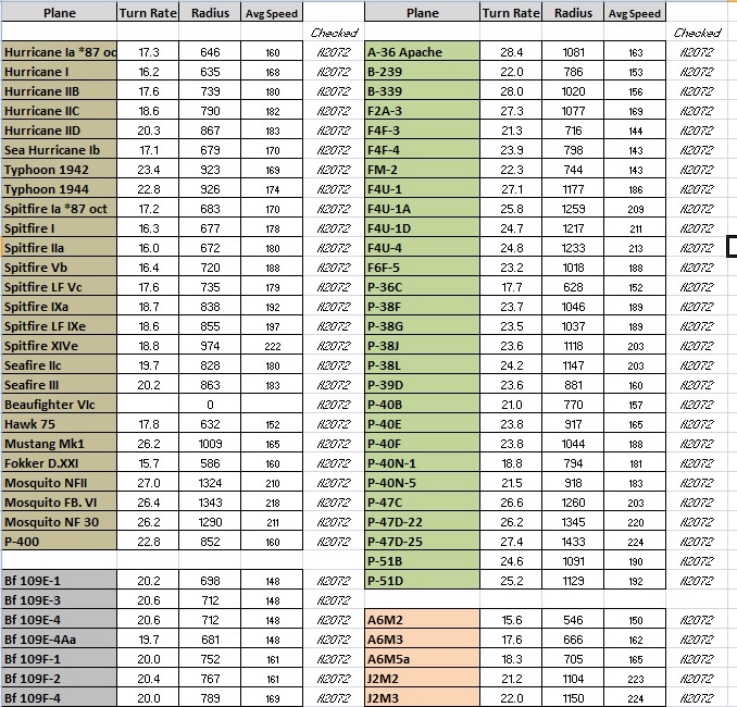

Also after two weeks of turning tests I've finally finished clocking the sustained turn rate and radius for all 100 fighters at 12 000 ft, 75% fuel, no flaps. I will add this to each fighter's Vehicle Info data for the coming FL2073 update :-).
