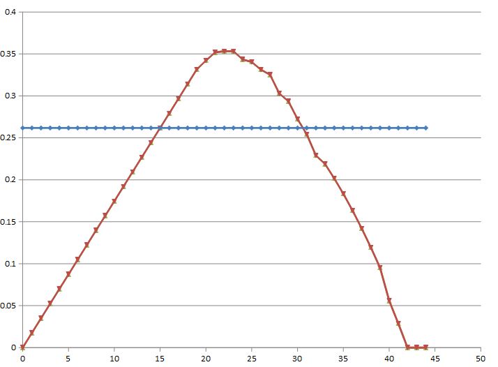

One thing that always bothered me since first looking at FMs was the wings.
A lot of time was spent in the past to get pure "performance numbers" right but nobody ever seemed to look at the wing profiles.
A darn important component of an airplane !
What does it do ?
Well you have a LIFT side that goes UP from 0 degrees up to the maximum AOA set for the plane.
Then you have a STALL side from the max AOA down. This determines how aggressively (or not) the stall is.
In the attached example, the max AOA has been set which does NOT match the wing profile (BLUE LINE)
What does it mean ?
Well instead of losing lift (stalling) at the prescribed AOA of 15 degrees.... it "MUSHES" across that blue line until you hit the downward (STALL SIDE)
One which is set up correctly will have the blue line positioned across the PEAK of the red line
so that when it hits the max AOA, it stalls and follows the loss of lift curve down.
So like I said... a lot of well intentioned effort had been made in the past to get numbers right but was missing a fundamental component.
Planes don't just fly straight and climb on auto. They turn too..
(credit to the backroom FM boffins for making all possible)

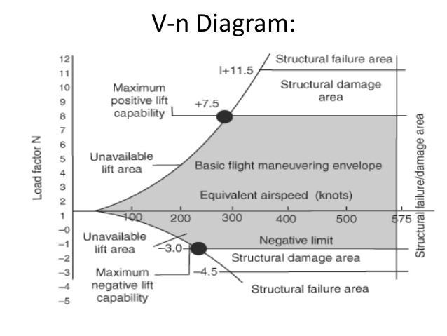

In case you haven't seen one before, this is called VN diagram (EXAMPLE ONLY)
As you can see..
1. This plane has a POSITIVE G limit of 7.5G. Above that risks structural damage (and +11.5G failure)
2. This plane has a NEGATIVE G limit of -3.0G. Below that risks structural damage (and -4.5G failure)
2. This plane has a VNE of 570 mph. Above that risks structural failure
It also give you a couple of curves.... (we wont bother examining the NEG G side as its the same but in reverse).
So for this plane.
At 150mph, you will stall if you pull 3G or more.
At 200mph, you will stall if you pull 4.5G or more.
At 250mph, you will stall if you pull 6.5G or more.
Typically will happen during a banked turn as an "accelerated stall"
- Level flight is 1G
- A 60 degree banked turn requires a load factor of 2G
- Based on structural load limit of +7.5G : the steepest bank turn allowable for this plane would be (a function of cosine) = 82.3 degrees
Of course you can always just yank the stick back and hope for the best
